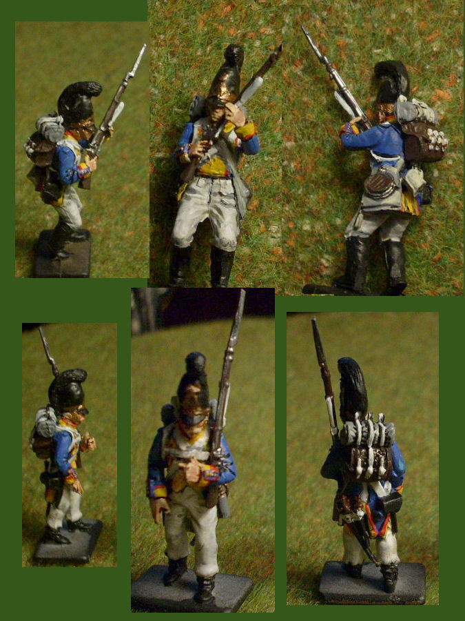

In an effort to give the Eureka Tyrolians some colourful opposition, I tried a mash-up project with left-over plastic bits. They are far from perfect but I think they might just get the job done. Excuse the slap-happy paint job.
The heads were the Carabinier heads from the Perry Heavy cavalry. A dollop of green stuff had to be applied to the top of the helm to round it out.
The figure with the arms at the port is a Victrix British flank company body with Victrix French line infantry arms. I had to trim the belly to remove the detail of the British lace and opted to carve up the legs a small bit to remove trousers and make it more booty.French backpacks were used so the figure is weighed down by plenty of gear on his back.
The marching figure is a Victrix French infantry body with French arms and pack. The waistcoat is wrong and he gets shoes instead of boots but I can call that campaign mode. In order to get the cross-the-chest strapping, it was simply a small strip of paper affixed.
My thinking is that as I proceed with the unit, I'll go with the British torso.

Nice conversions, but is it worth it to build large regiments that way?
malcolmmccallum29 Oct 2009 5:55 p.m. PST
In a sense they are free since it is done with scraps after I'd built what I bought the figs for. I won't be making large units of these, no. Perhaps two groups of 12.
There's perhaps an additional 5 minutes work per fig when putting them together (not counting rooting around through sprue debris for bits)

very nice helmets – congratulations the figures look great, in case you do further conversions – also make a bigger cartridge box flap, those on the figures look rediculously tiny
